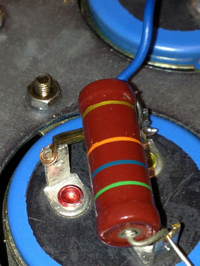

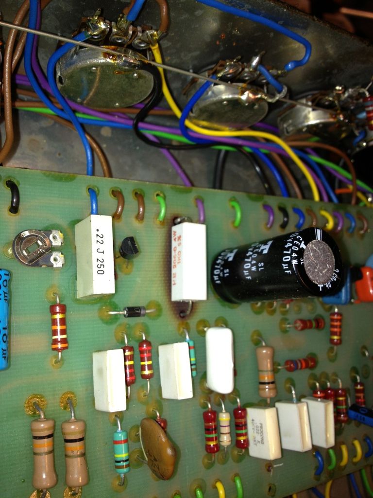

Some issues.
Pots were mega dirty, cleaning the jacks and tube sockets as we speak.
Didn't originally see this, but in the for sale ad the guy said it was blowing fuses. Doh.
Got damn lucky this time. As he was using a 1A fuse instead of the 5A fuse it needs.
Whew.
Not soldered
Looking dark. Not sure if I should care.
Whew.
Not soldered

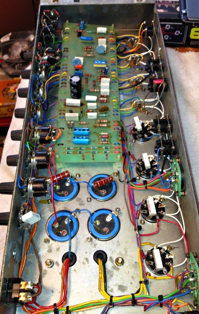

Wow, that shit's wired like a Marshall, well, like Marshalls I've seen from the 70s. This is a Laney? I know nothing about them. I will have to look into them.

Okay, I've just been staring at the schematics and was having a hard time figuring things out, I'm so used to older and simpler amps, but this thing looks like it has a butt-load of gain in the High input.

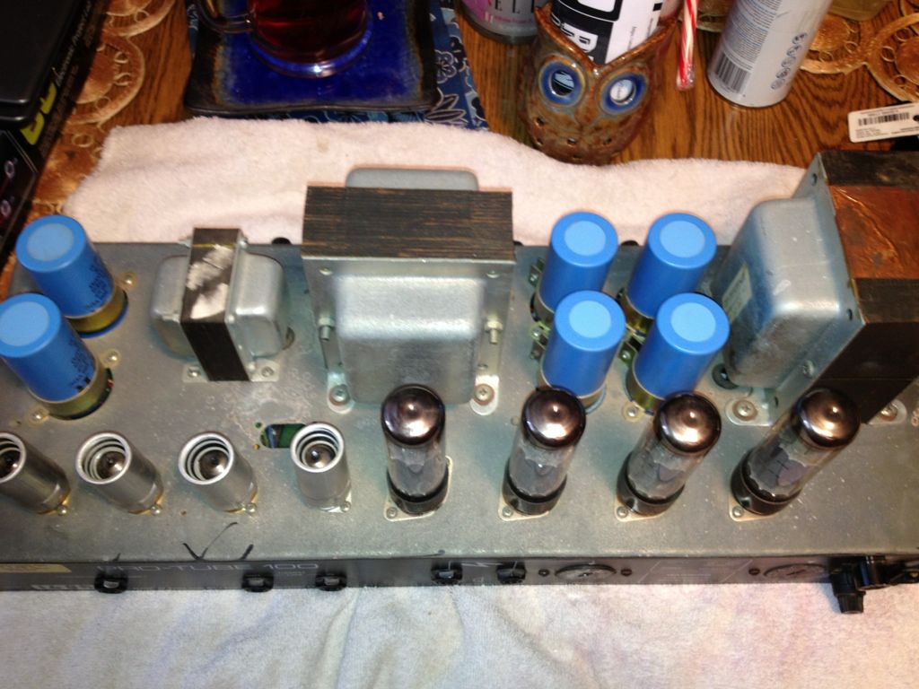

Hugh Jaynus wrote:Will old tubes make this amp shrill? I'm assuming they're original.
The power tubes in the picture above are east german RFT EL34s. Generally great tubes. I'd expect that old tubes usually tend to make an amp darker, warm sounding, not primarily shrill.
