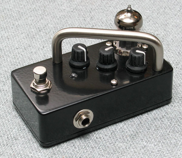

I stumbled in to these on the internet last year. It is such a simple design and I have a big pile of vintage 12AU7 & 12BH7 tubes so I decided to slap one together. This pedal actually runs off of a 9vdc power supply but I use a 12v one I happened to have on hand.
Here a pic of my first. I was too impatient to paint the box before digging in. I made the tube guard out of big washers, stand-offs and screws.
It's basically a clean boost and it has a truckload of kick without all the HISSSSS you normally get from them. It's great for giving a lightly broken up tube amp a huge kick in the pants. I also like to run an OD in front of it to get the Valvecaster itself crunchy. It's loads of fun and about $40 or so to build. I put an amber LED under my tube socket for an indicator light to enhance the glowing tube effect. The filaments in the tube are always lit but the LED makes it look like it only goes on when I step on it. Here is a short video showing that feature.

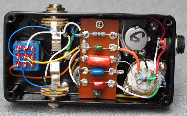

Any chance of a gut shot of the pedal? Recommendations for caps?

HA! I think it's a rat's nest but I'll open it up for a shot. I don't remember what I used for caps but I don't remember being real picky about the components. I ordered everything through Antique Electronic Supply but the tubes and some of the resistors which I already had.
****** UPDATE ******
Here is the rat's nest :facepalm:
....but it works. :idk:

Re: Valvecaster pedal
I didn't even notice before - but I guess you had to add a switch to the circuit layout?
Do you just switch the power in and out - the LED on and off - and true-bypass the entire circuit with the three different sections of the switch? I really wouldn't even know how to do that...........

It's doable. You just have to look for a diagram with the switch added.
I like this build design. It would be cool to Use IC sockets so you can swap caps & resistors to do gain & tone tweaking.

Hey man - thank *you* for taking the time to do that. Looks good, although I'd be more inclined to go the route of the other one you posted. Doesn't matter much, though - yours sounds killer, and I've already gotten some of the parts needed to make a test unit for myself. Thanks for showing up, and hope you stick around!
