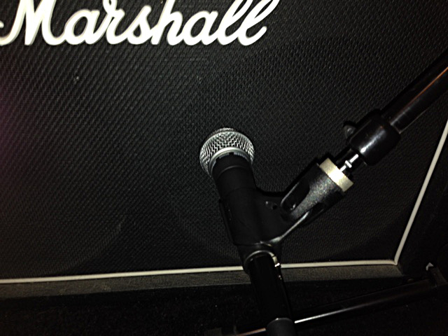

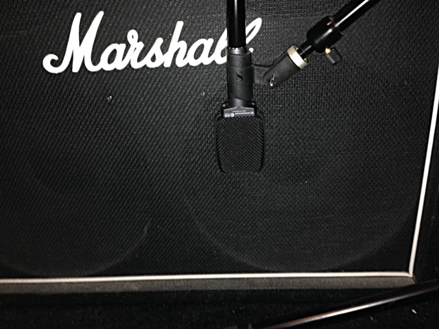

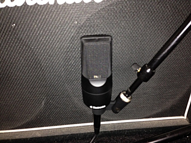

And EndTime, the amp really isn't bright at all in the room. And the mics are actually right off the edge of the dust-cap. My photos are from fuck-awful angles.

nightflameauto wrote:Yeah, just messing around the 58 + the X1R sounded really good together.
Damn you angles!!! :lol:

EndTime
Posts: 7767
Re: NMD, Comparison clips (e609, SM58, sEX1R)
Post by EndTime »
nightflameauto wrote: And the mics are actually right off the edge of the dust-cap. My photos are from fuck-awful angles.
Fair enough, but ime, you are still going to want to move the ribbon mic closer to center, if not dead center... It'll lack a lot of highs and cut otherwise.. Its a whole different ballgame as far as mic placement..

Yep. I'm really thinking I tweak the preamp to match the X1R, and it will sound pretty damn epic. But right now the 58+X1R mix is about the best I can get out of what I recorded this morning.
I'll have to experiment with placement, EndTime.
