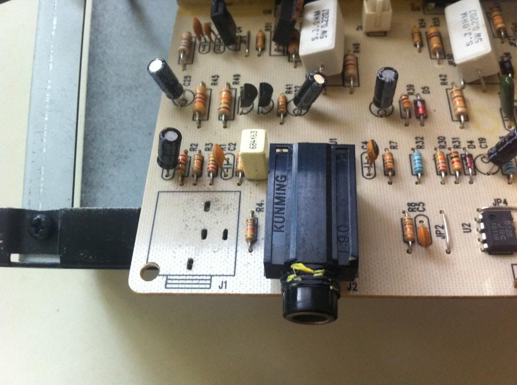

The most common problem with low cost solid state amps is broken solder joints on the input jacks. I've repaired a bunch and all of them had that exact issue. The jacks and pots are pcb mounted and the act of plugging and unplugging into pcb mounted jacks stresses the solder joints and in time they crack and develop shorts. The first sign is a crackly jack that you have to wiggle the plug in to make contact. Eventually they stop working all together. The solution is simple, re-flow the jack's pcb connections with a soldering iron and some solder. Getting to the part is sometimes a big pain in the ass. You start by removing all of the knobs and mounting nuts from the pots and jacks so you can remove it from the chassis. The solder connections are usually on the bottom side. This is the kind of thing you will be dealing with. The top side where the jack is will look something like this:

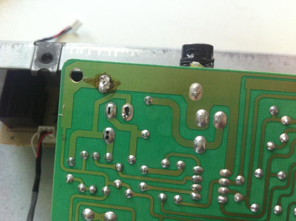

The bottom where you re-flow the joints will look something like this:
In this case the tech is replacing a broken jack. The last one I did was a Fender FM212R Frontman and there was quite a bit of disassembly involved to get the pcb out. I replaced 2 broken jacks and re-flowed the rest in that. If you find you have a broken one you can buy replacements here: https://www.tubesandmore.com/products/jacks_plugs Good luck!
