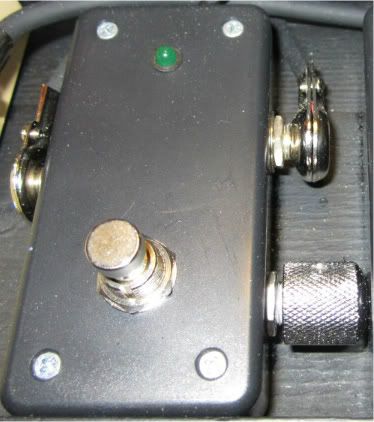

You can use a clean boost in the loop for raising the amp's overall volume and it won't change the tone of the amp if the pedal is neutral sounding. Awesome way to bring up solos if the soundman is asleep. Myself, I prefer to go the other way and use a rhythm cut pedal, then kick it off (bypassing the pot) for solos.gorkyporky wrote:...the list says that the effects loop tolerates MXR Micro Amp and the TC Booster Line Driver. Would putting that in the loop boost my overdrive channel a bit louder as well? Because when i put an overdrive in front of the amp, it just gets more gain and changes the tone, but not the volume...
Homebrew with RatShack parts...

Big John wrote:You can use a clean boost in the loop for raising the amp's overall volume and it won't change the tone of the amp if the pedal is neutral sounding. Awesome way to bring up solos if the soundman is asleep. Myself, I prefer to go the other way and use a rhythm cut pedal, then kick it off (bypassing the pot) for solos.gorkyporky wrote:...the list says that the effects loop tolerates MXR Micro Amp and the TC Booster Line Driver. Would putting that in the loop boost my overdrive channel a bit louder as well? Because when i put an overdrive in front of the amp, it just gets more gain and changes the tone, but not the volume...
So this clean boost would work even with heavily distorted channels and at high volumes? I have my volume for the overdrive channel set at about 6 during practice. Would it still work? I mean this two specific pedals, the micro amp and the line driver?
I think the TC pedal would be the better of the two choices since it supposedly can handle the line level signal that the JCA50's loop operates at. The insert point for the loops on these amps seems to be the biggest headache with folks: pre-eq/pre-master. This is (1) why I use a cut pedal with a 10k pot instead of a boost pedal and (2) why I'm still snooping around to find the best overall fix for the loop.gorkyporky wrote:So this clean boost would work even with heavily distorted channels and at high volumes? I have my volume for the overdrive channel set at about 6 during practice. Would it still work? I mean this two specific pedals, the micro amp and the line driver?
