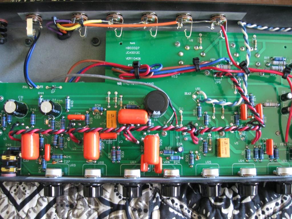

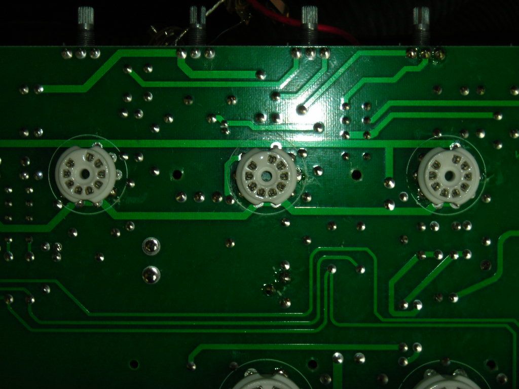

I'd picked up a pair of JCA5012C's recently and noticed the heater hum thing right off the bat like a few folks here had mentioned. What fixed it for me was cutting the backside traces and wiring in new heater lines.
Big John wrote:Just wanted to add my 2¢ to this cool lounge, which I found trying to search for mods. I mainly hang out at the MLP forum.
whoa nice job with the wiring! Looks great! Welcome to the forum.
Heya, Big John welcome to the club! Between you and the other guy posting his DC heater mod, I've been busy researching just what I want to try. I really like the DC mod, since it doesn't require permanently modifying the PCB. But then again, this looks really clean, and it's nice that it's just wiring, rather than sourcing and finding space for a DC power unit.

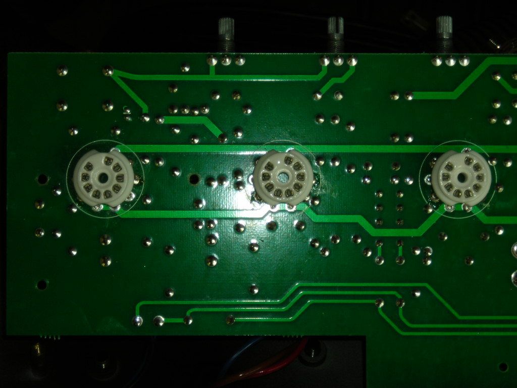

Any chance you have some pics of the other side of the board?
Also, I found your recent posts over at MLP. What's the deal with the cap removal mod you talked about there?
- Bassman overhaul - G-MAN
Sorry, I forgot to snap a pic of the back side. Removing that cap (C21) has the same effect as the Warren Haynes mod on the SLO. When the gain knob on the OD channel is below half, the tone is warmer because that little wiper bypass cap isn't there to let the highs thru. The "treble bleed" mod that players put on their guitar volume pots works the same way as that C21 does.

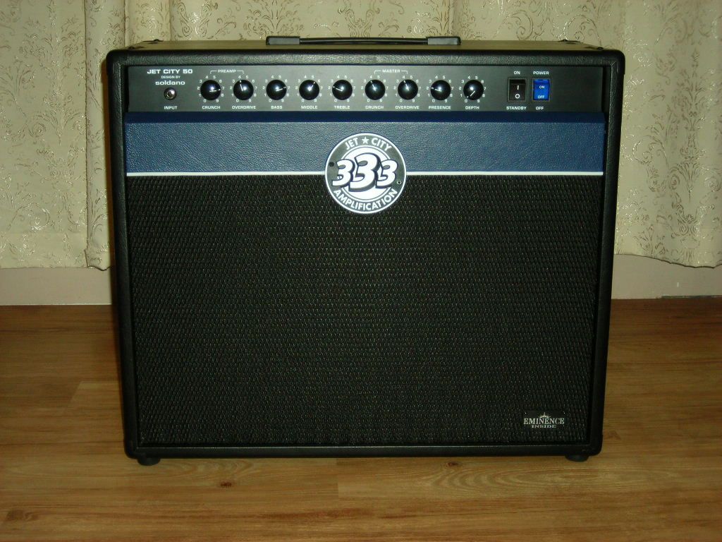

Ok guys had this amp jca50c 112 for a week now and have a couple questions
1. Does the jet city flood delay work in this loop?
2. My amp comes with a depth pot from factory, haven't seen any of these amps, is this a newer combo?

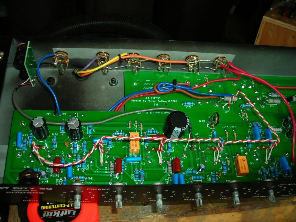

I had to join the heater club. Thanks for the inspiration Big John.

midnightlaundry wrote:I had to join the heater club. Thanks for the inspiration Big John.
Damn, dude - you beat me to it. How'd it work out? Any pics of the traces you cut on the back?
Also gotta do the ext bias when I bust it open...
This thread keeps getting better and better!
- Posts: 1599
- Joined: Tue Jul 09, 2013 10:36 pm
It worked real good. I used the 18 gauge wire which is a little harder to work with, but it's worth it. It took away that ratty buzz my amp had.
I used my Dremel with a cutoff wheel for the traces. It's fast that way. Just cut them off around each tube pin so they're out of the picture. No big deal.

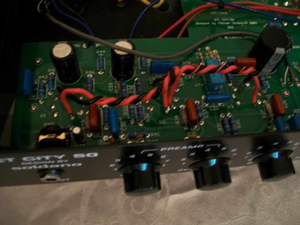

just got JCA22H for couple days.can't wait till my parts coming and want to stick my solder for the MOD
*sorry for my poor english,not my primary language
adding some photo so it becomes official

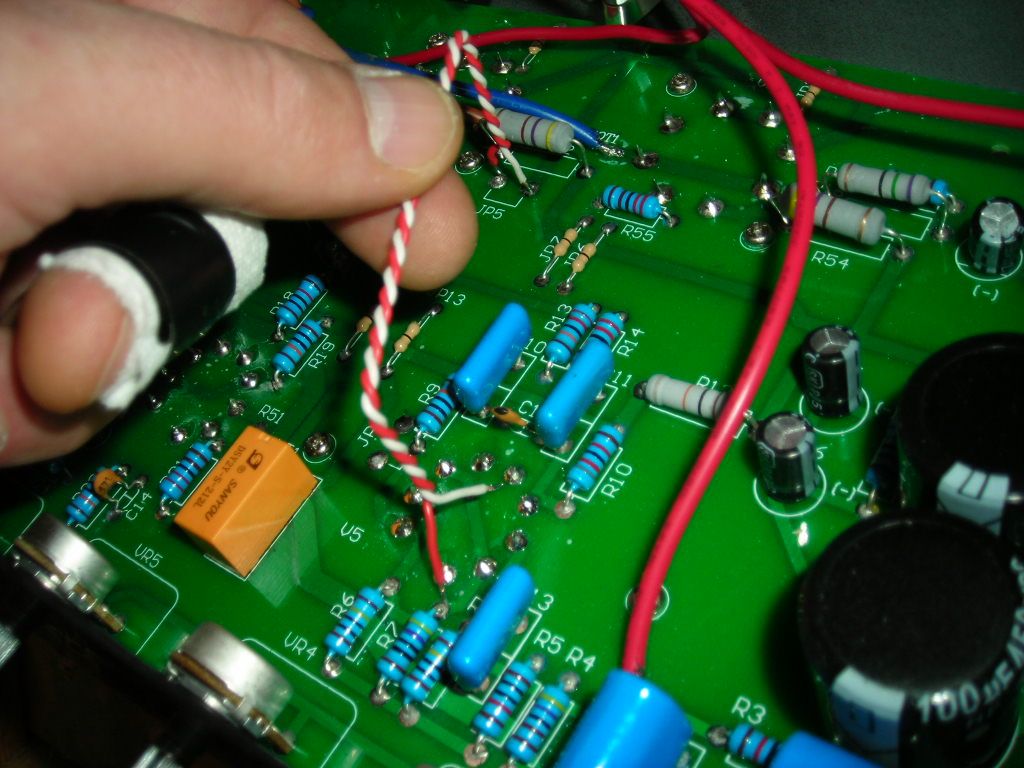

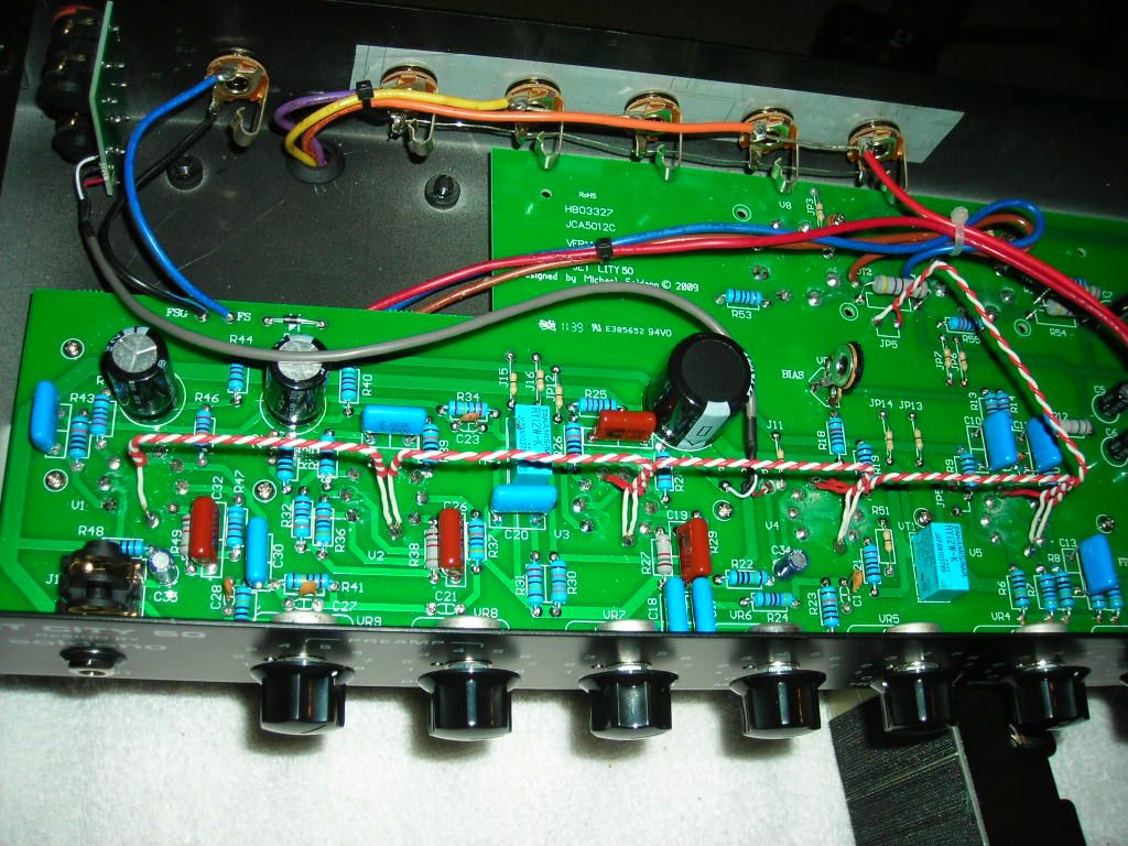

Looks like the twisted heater wires are the official fix from Jet City. Dude over on the MLP forum got his 50w chassis back and this is what got done. Owner says the hum is now gone. Looks like they left the PCB traces in-place between V3-V4-V5 and just flew the wires between V1-V2-V3...
Interesting that they curved the heater wires between V1-V2. May have to try that.

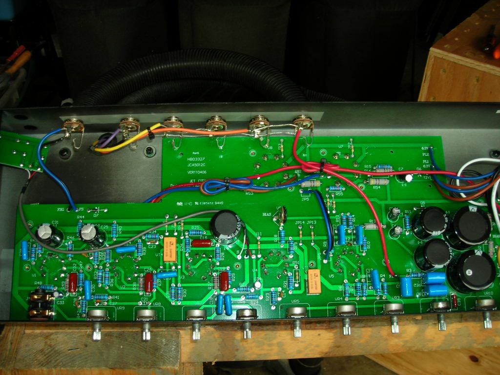

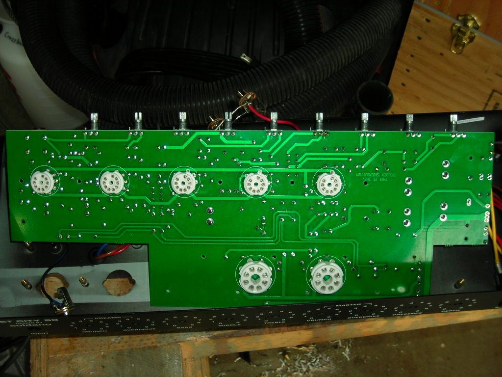

Quick and dirty "How I did it" for putting in a new heater supply for my JCA5012C (combo version of the JCA50H)...

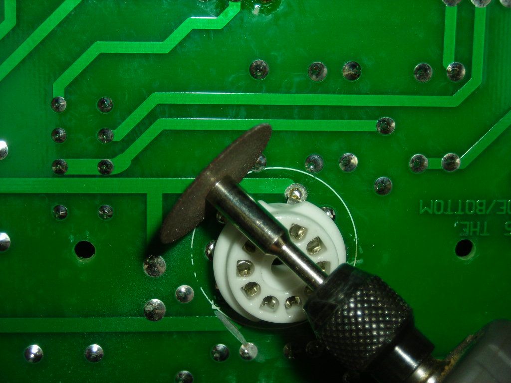

I removed all knobs, nuts, & washers on all the pots and jacks front and back, and the PCB screws that hold it to the stand-offs. I have to get the speaker/footswitch/fx-loop jacks loose and out of the way to make the flip possible, as well as snipping the zip ties...

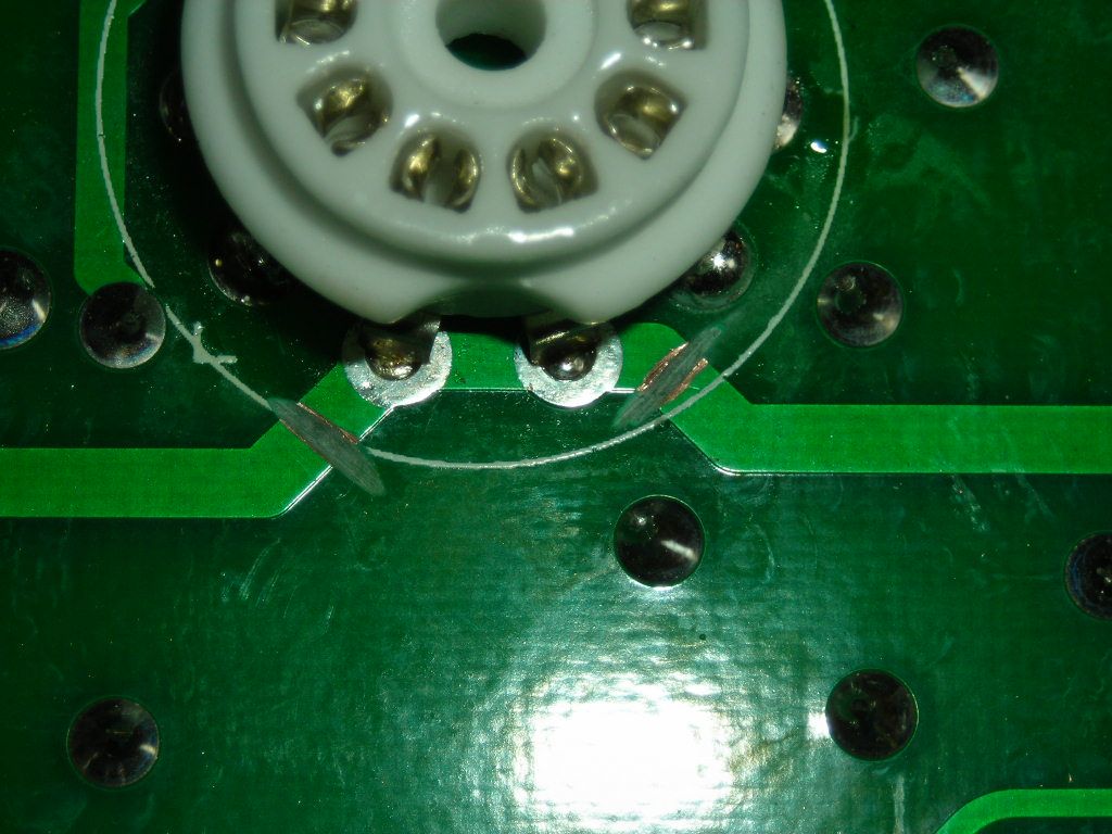

The long traces that go from preamp tube to preamp tube are the target. They attach at the top and bottom of each socket...
I used a Dremel with a cutting wheel. Keep a steady hand and go slow. Don't need a lot of speed or pressure on the wheel: "hot knife thru butter". Found that out on the first cut which you can see on the lower trace...
While the PCB is flipped, took the opportunity to de-solder the blue/black jumper wire on the front of the PCB that goes from the power tubes to the preamp tubes (JP5-JP5).

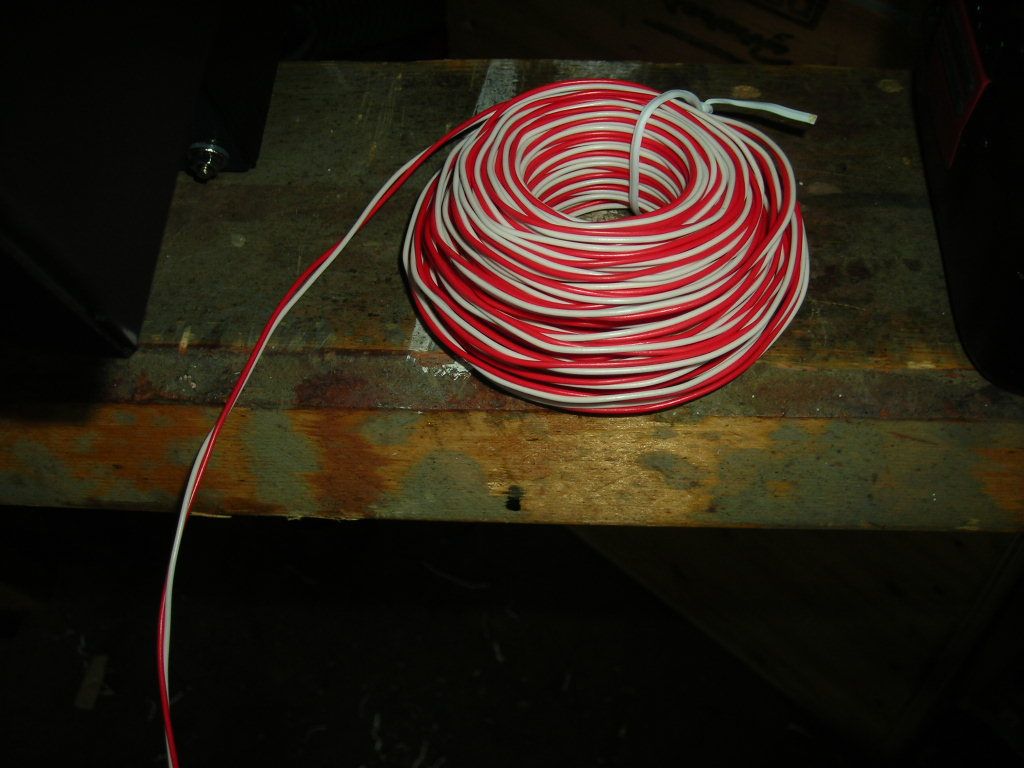

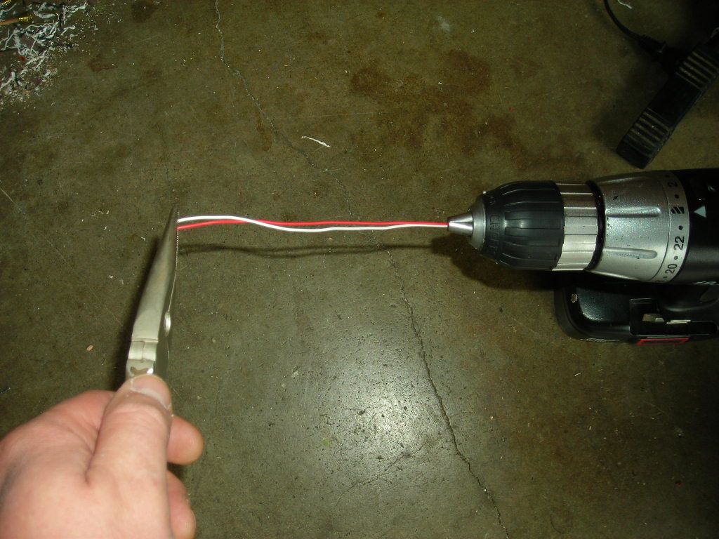

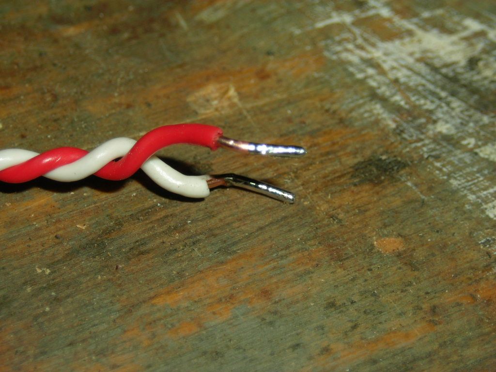

Now it's time for the new heater supply. I used a $7 spool of doorbell wire from Home Depot; 22g solid core. The wire itself is fine, but the insulation shrinks damn fast if you park the soldering iron on it. Gotta be quick with the heat...

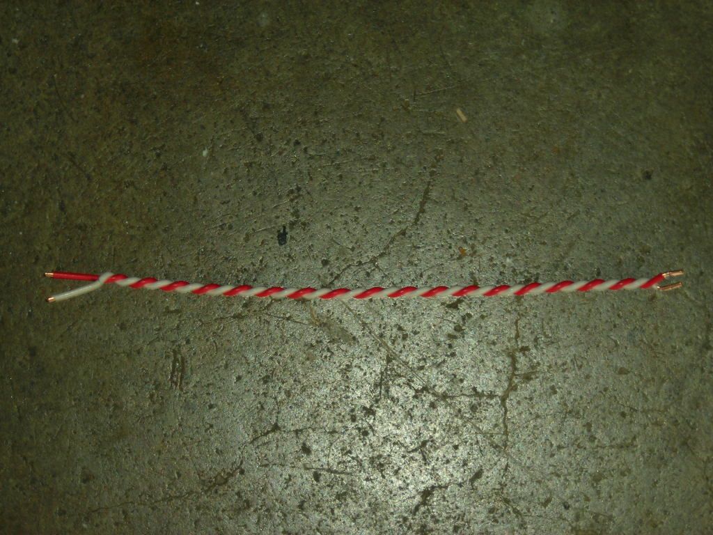

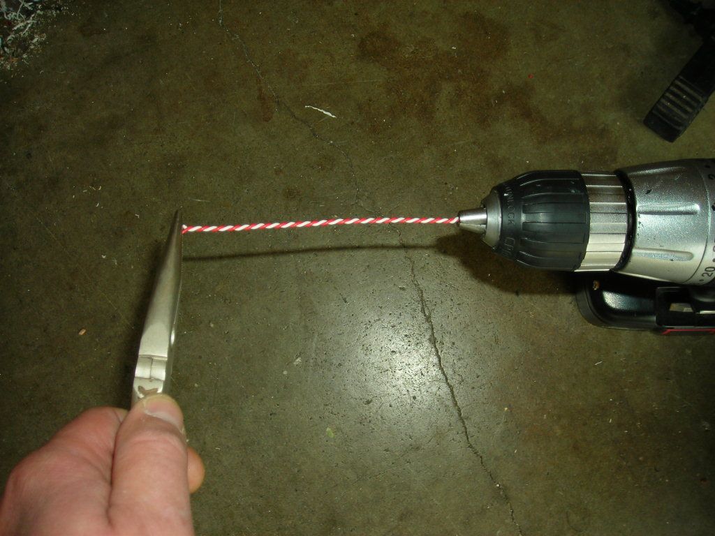

Getting the twist is easy. Cut the wire to about 6-8". Chuck one end into a drill and hang onto the other end. Don't have to twist them too tight; this shit insulation will tear if it's too tight...

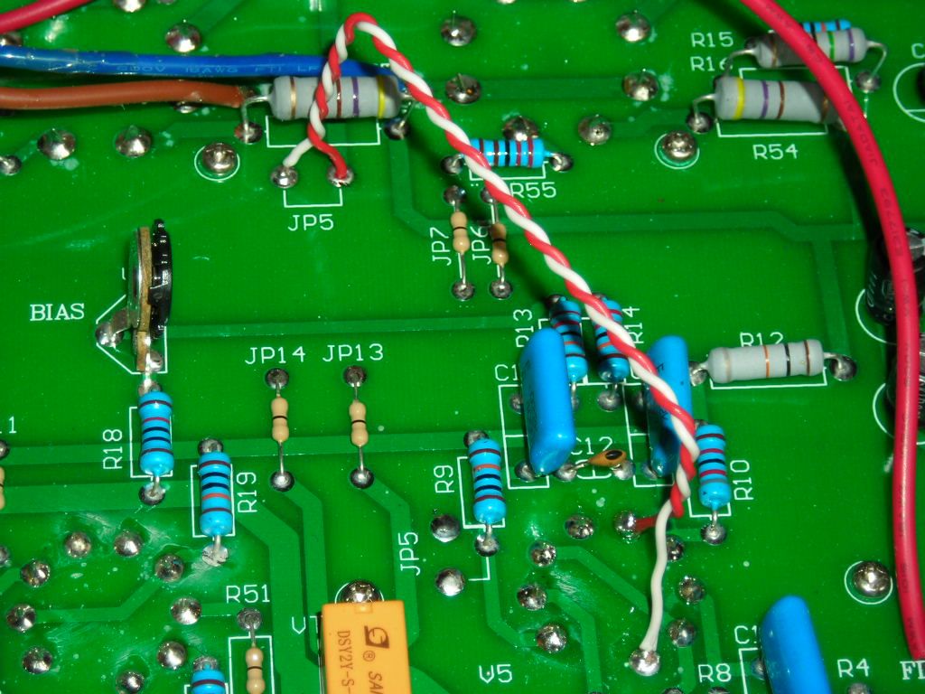

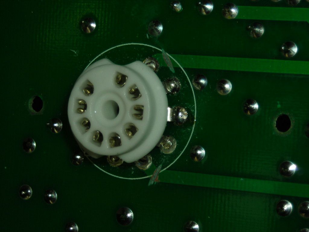

First leg to put in is the jumper that goes from the power tubes to the preamp tubes. This is just old school bending/trimming/dry-fitting/repeat. Don't pay attention to my redneck band-aid...
Happy with the fit, so tin the ends. I didn't strip the insulation back at all with this wire. It shrank back on its own from the heat.
One jumper down, four more to go.
For the last jumper, I curved the supply to mimic what Jet City does. Done deal...

With all new tubes and a re-bais, the amp is now much quieter, and both channels are warmer. Right on.
