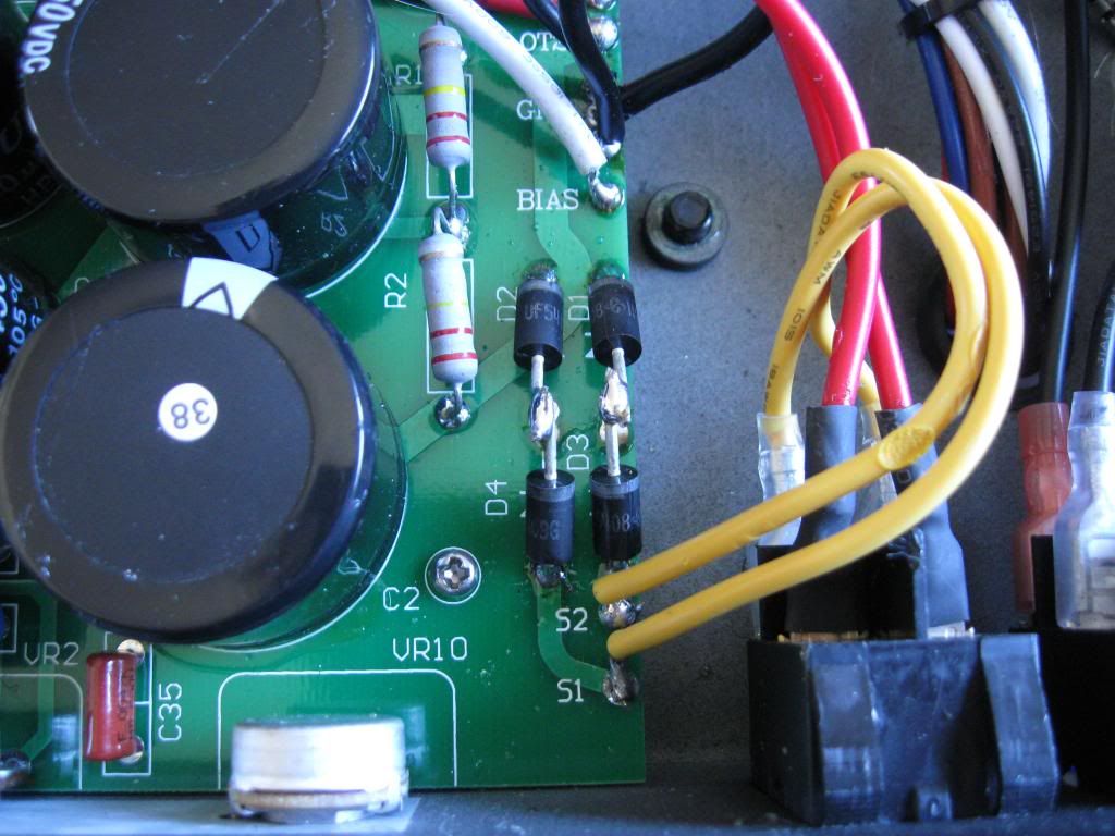

I changed the rectifier diodes to UF5408's. That went a long way in cutting the buzzy fizz in the background.
I've got quite a bit of hum / buzz going on with my amp. I was thinking that some of it would be caused by my not having the metal tube covers on. Does that make a big difference? If not, do you think it'd be worth changing out my diodes?
UF5408's are rated at 1000 volts and are beefy as fuck. What they will do is a better job of converting AC to DC. In other words, there will be less switching noise thats amplified throughout the whole amp which can be attributed to as buzz and hash noise.
See, diodes only conduct electricity 1 way, so when AC current flips, the diode will clamp, preventing current flow in the other direction. This switching can be heard in the audio. In some amps, this switching contributes to the amp sound in highend content. But I think the JCA's have enough highend, so adding the diodes will purify the tone a bit, allowing you to add more tone control.
If you don't like it, you can always change it back. Diodes are cheap.

Dude, I knew these were UF5408's Ultra Fast recovery diodes.
I just forgot the real part number. The ARE UF5408's..

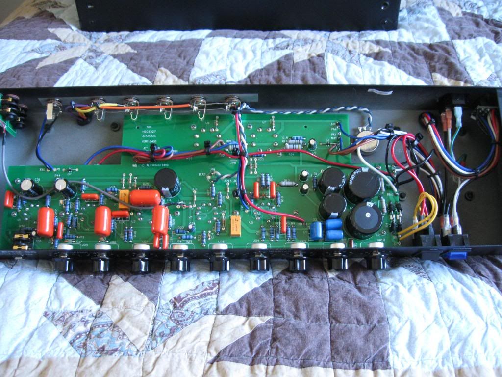

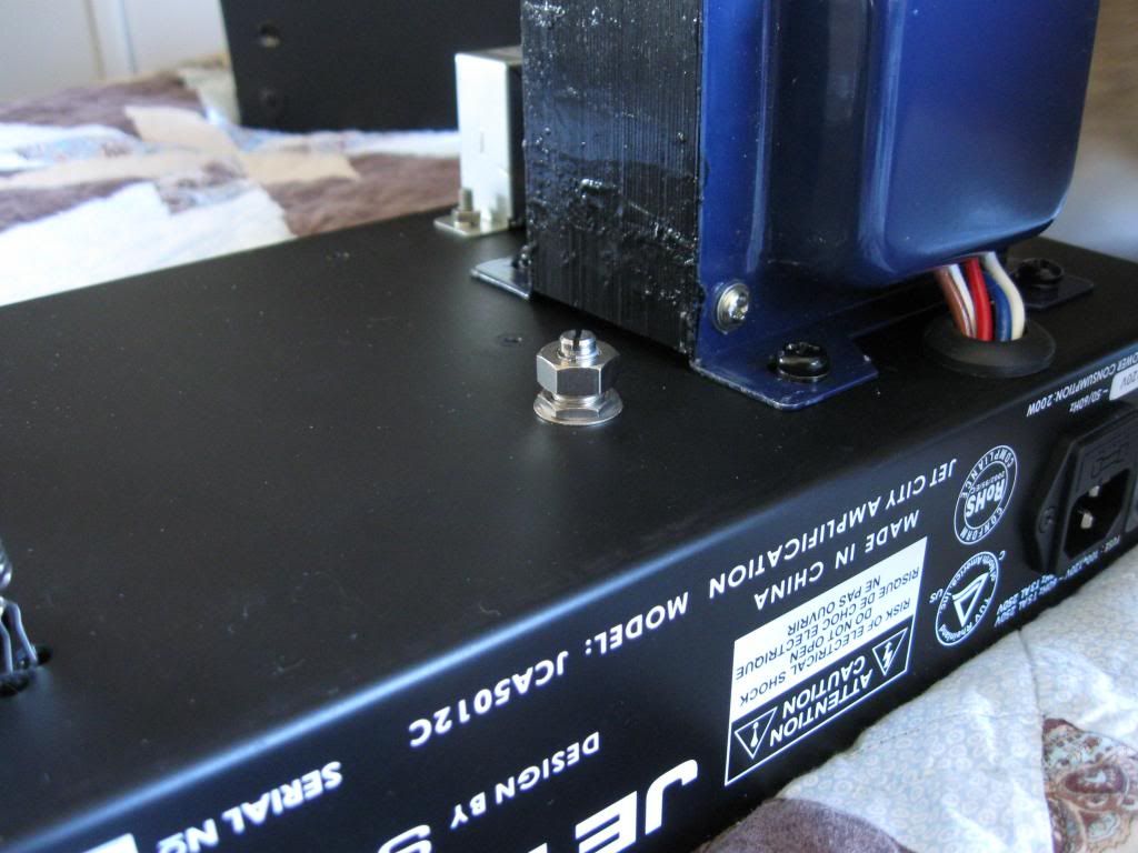

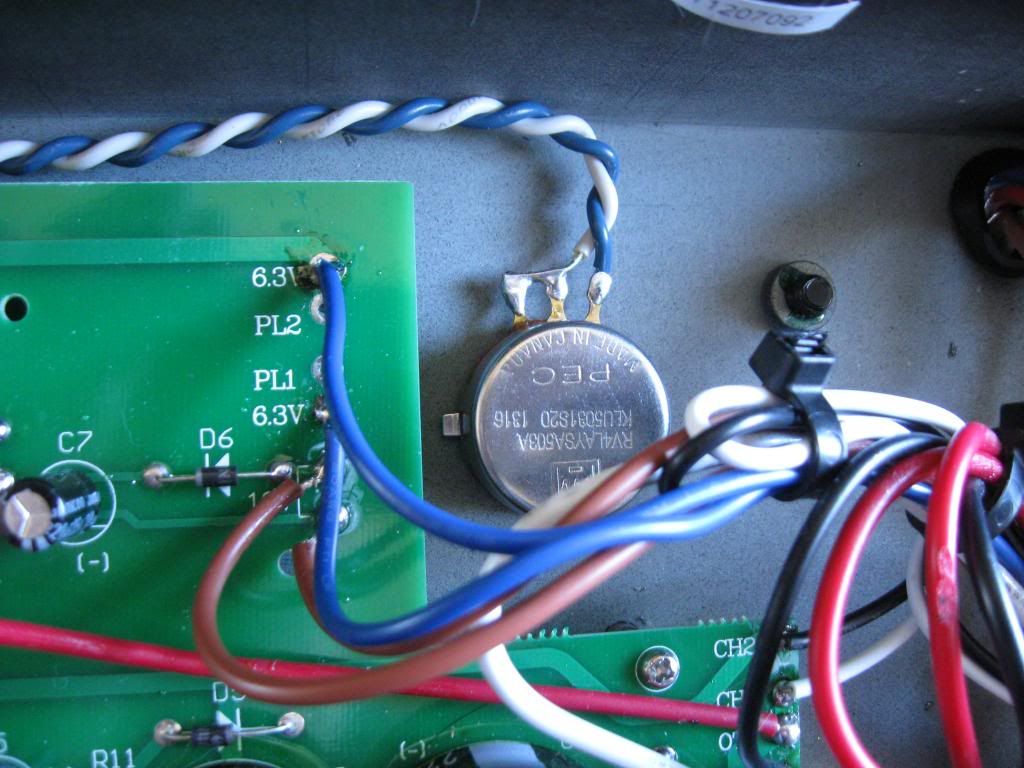

I went with 225P tone and coupling caps, an external bias pot that I use with an Eurotubes Pro Ine Bias Probe, and the UF5408's. I might go with some Silver Micas over the stock ceramics latter on.
Here's some pics. Dig my clumsy burn marks..

@midnightlaundry - great pics, and much appreciated! Really like that you covered the external bias adjust as well. I'm wanting to do that, along with putting in a set of external bias test points. I take it that all the orange caps seen on the board are the ones you replaced. Did they make a huge difference? Any chance of a list of cap ID #s, and did you alter any of the values?
