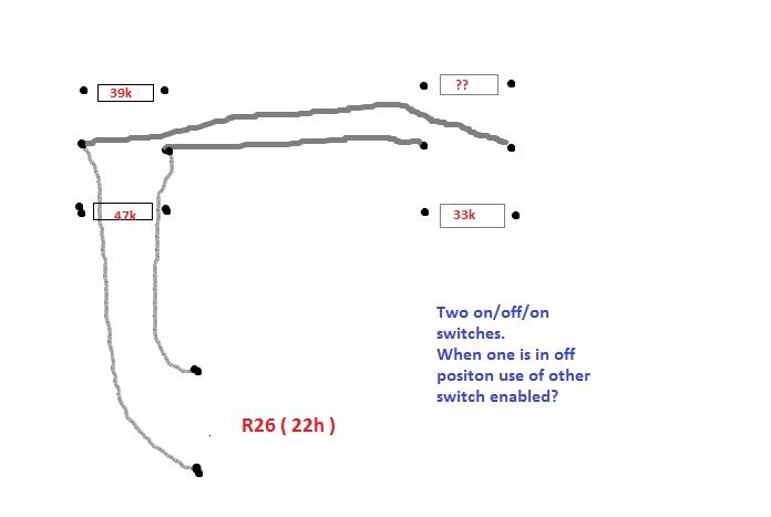

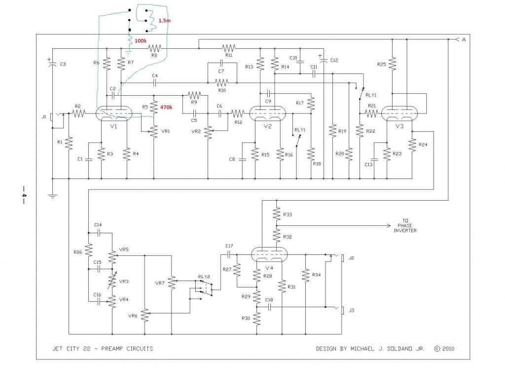

Hi guys, I'm still trying to get my head around the decadence mod. I was looking at both the 50 and 22 schematics but still cant seem to figure it out.
I've done a very crude diagram, am I on the right path?

Jase01 wrote:Hi guys, I'm still trying to get my head around the decadence mod. I was looking at both the 50 and 22 schematics but still cant seem to figure it out.
Jase - as with the SLO clean/crunch switch, you have to put part of the switch between the cap and resistor, as I've show below - I placed an 'X' over the wire you drew in that is wrong and another 'X' where you have to interrupt the connection between cap and resistor. The other line is where you need to connect back to R42.
My suggestion of lifting the one side of C2 (which is C30 on the 50/100) and soldering the switch to that still stands. I can't speak to long-term reliability, since you'll now have a component half-hanging with a wire attached to it, but from a circuit perspective, it should be kosher. If nothing else, I'd zip-tie the wire to something sturdy (ie: another component) near C2 - just make sure you cover the wire/cap connection with shrink tubing.
Let us know if this is still not making sense to you. I think I can draw it another way, and will try to do so in the next day or so if it's still not clear.

GRIMESPACE wrote:Jase01 wrote:Hi guys, I'm still trying to get my head around the decadence mod. I was looking at both the 50 and 22 schematics but still cant seem to figure it out.
Yeah Grime, if you do another diagram that would help me more, I kinda get it but aren't certain and don't start something until I am,
Would the crunch channel gain mod still work with this? Sorry for being such a dumbass!!
Oh and I'm still keen on multiple switches for more options with the slope mod so If anyone out there has any ideas I love to hear them.
Heres my idea for a switch setup for mulitple slope mod options. As you can tell, I'm no artist and if you've read my earlier posts you'll know I'm no electronics dude either!
Or is there a single toggle that will do 3 or 4 switchings?

I'm also interested in the slo mod, and would like to see pics. I probably wouldn't do a switch, though.
I did the depth mod, but can't hear a lot of difference. 22h, by the way
"Madison Square Basement !!!!"
kissmyace wrote:I'm also interested in the slo mod, and would like to see pics. I probably wouldn't do a switch, though.
Man, when I did it to my 22h the difference is amazing. Maybe you've done something wrong, but I'm defiantly not the person to ask here! haha Grimespace seems to be super switched on.
Jase01 wrote:Heres my idea for a switch setup for mulitple slope mod options. As you can tell, I'm no artist and if you've read my earlier posts you'll know I'm no electronics dude either!
How noticable a difference are we talking about here? With the 33k I seem to get some more higher mids maybe and a bit less bottom end than the stock 47k. Does that about right to you guys? The more I played the more diff I noticed..
