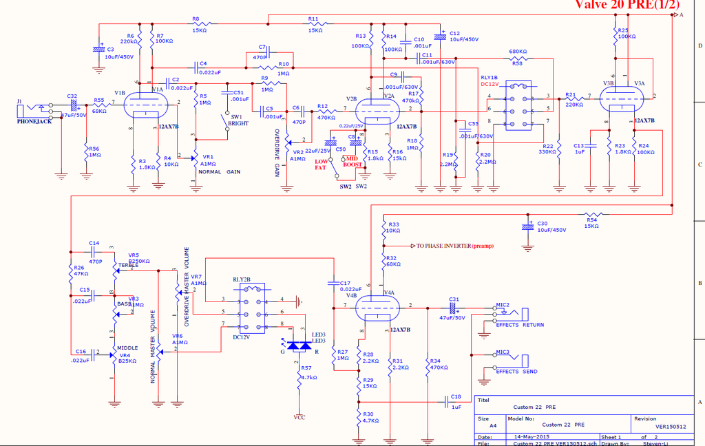

BRUNO wrote:Sorry bumping this post but where did you get that Custom 22 Schematic ? Something looks weird to me .001 coupling cap with the same cap to ground just behind after 3rd gain stage of OD channel ?
Thx
Brunocapota wrote:I don't think that anyone has the Custom 22 Schematics))
who can help me to tame down the gain on the Lead channel?? I've Already changed the R6 from 220k to 110k (switchable) and changed the Slope resister (R26) from 47K to 33k (Marshall feel, also switchable). I want to make it a bit more Marshall flavor.
Also cut the C6 but it made it too much of a dark amp. What value for the C6 (Bright cap) do you guys recommend??
Thank You!!!

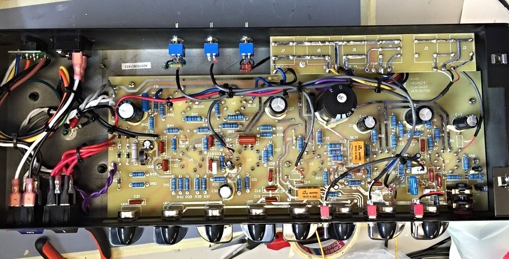

Here it is after the mods
Here is what Martin Kidd suggested for reducing gain to a more acceptable level (relayed to me via Doug):
"R17, change to 680K from 470K; R18, change to 220K from 470K and remove C57 which is a 470pF across R58"
I did that to mine yesterday (I actually have a prototype Custom 22), and it did the trick VERY well.

Hi guys and gals. My story....
Ok so I got a JCA 20h gave it to a amp guy to do this mod - http://s150.photobucket.com/user/TnP...d%20-%20JCA20H
Got it back and it sounded awful.
Took it back. He checked it all out and he is confident that it's exactly as the mod says. It cost me £180gbp for the mod.
He still has the amp but he's tearing his hair out trying figure out the problem.
Any help advice welcome
Jim
Jim

I've done some mods to my JCA45 (JTM45 clone) to get it close to what I refer to as "EVH specs", plus a little extra. I originally did the 'one wire mod', but it was just too much gain for what I was after, and I did IMO take away from the 'plexi' feel of the amp. So I removed it and tried a more traditional approach to goosing it a little.
I converted the shared V1 cathode to split (I may revert back to shared but I dunno), changed the NFB resistor to 47k (it was 27k stock!!!!), added the Jet City HV solid state effects loop, Channel 1 bypass cap to .0022uf (.022uf stock), added a PPIMV, and tomorrow will change the fizz cap to 100pf (47pf stock), and a solid state rectifier plug-in. Also have a 50 watt OT coming in to properly convert to EL34.
Stock:
Here's what my board looks like as it sits now:
Stock:
