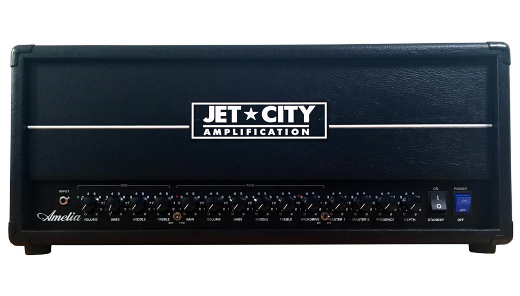

The new Amelia amp just hit presale at Musicians Friend for $499:
http://www.musiciansfriend.com/amplifie ... ifier-head

From my post in the other thread...
$499 seems like a killer price for this amp! I'm most interested to hear how it compares to your Earhart, Sahl :thu:

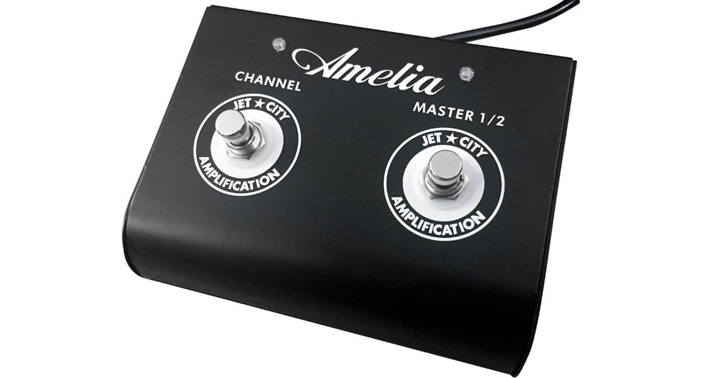

This thing really looks awesome. EQ for each channel, and I wonder what's with the dual masters for Ch 2? One for regular, one for lead (louder)?

As soon as I get my DSL sold I'm putting down for the Amelia. :D

sahlomonic wrote:The new Amelia amp just hit presale at Musicians Friend for $499:
Tubes: two EL34 (preamp); two 6L6 (power amp) :rolleyes: :lol:

GRIMESPACE wrote:From my post in the other thread...
I doubt it is for ch2 only .that is basically two masters thus two different switchable volumes for the whole amp..whatever the channel used... You can find this feature on a lot of amps especially most ENGL's

Ok dudes, I'm back. And with TWO brand new amps to show off :D
First is the long awaited Amelia. Took delivery of her Friday. This is one hell of an amp for $500. It's not quite the same as the infamous Earhart, but it has it's own mojo going on. Bottom line - I'm retiring the Earhart from gigging use and have switched to the Amelia.
Functionally, it operates the same as the Earhart (and Cornford MK50H II).
The clean channel is what all of us Jet City guys have been wanting in our amps all this time. An actual clean channel. It isn't pristine glassy CLEAN clean, but it has a hint of breakup on it that I prefer on my clean channels. I never really bonded with the Earhart's clean because it was just too clean and almost sterile glassy sounding. I like a touch of grit and breakup.
Gain channel can give you JCM800 level of gain when you dime the knob, and switch on the Overdrive boost and you can get modern metal levels of gain. You won't be getting 'djent' style tight crisp low end on this, but this is an all around killer rock amp.
