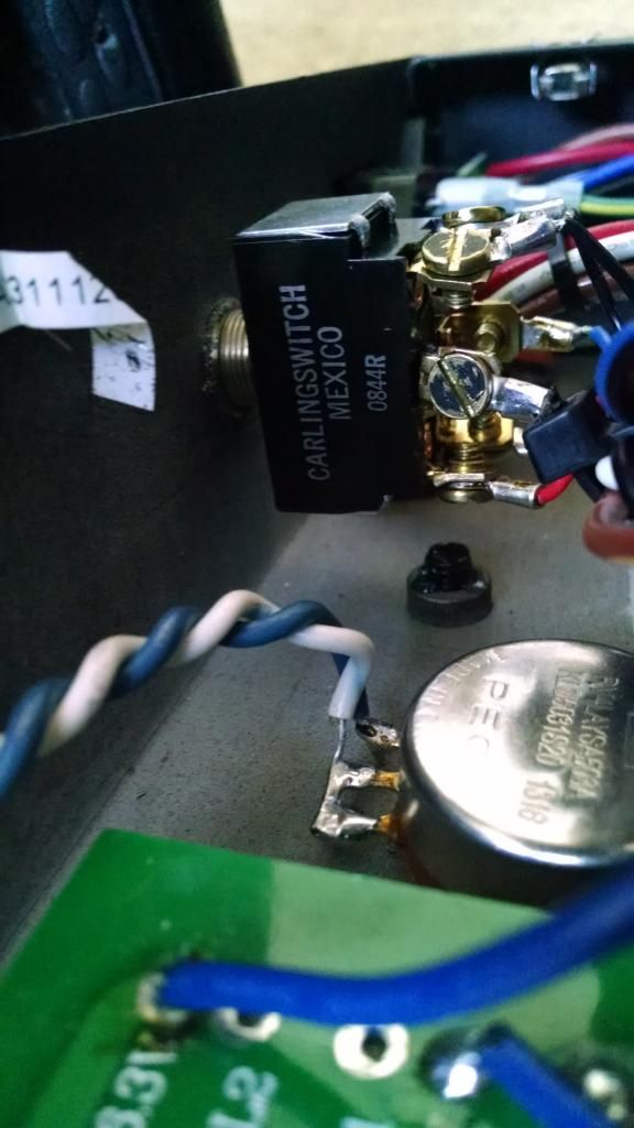

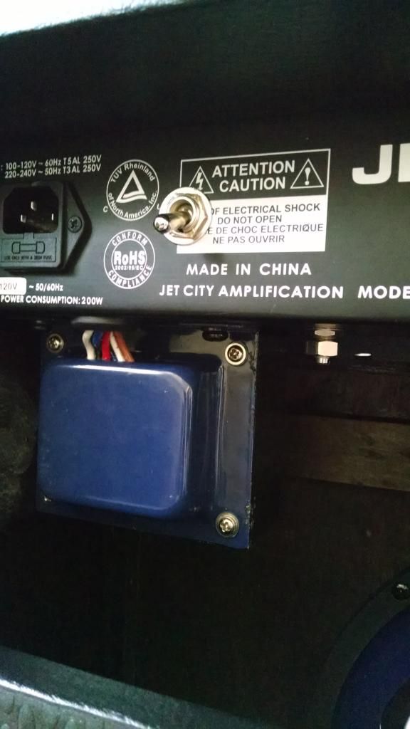

I'm surprised nobody has done a Triode mod. It's super easy, and adds a cranked tone and cuts the power at the same time. There's a noticeable volume drop which is cool for low volume playing.
All you do is use the amps existing Screen resistors, and connect them to the Plate supply coming from the Output Transformer. I used a beefy DPDT switch to go from Pentode to Triode and back. I think this is a simple and worthwhile mod on the 6L6 amps. You can do it to the EL84 amps too. It's way easy to try out to see if you like it. Just lift the one side of the Screen resistor, and solder that end to the Plate supply of the power tube. Make sure your caps are drained first.
Warning: I did not go for a clean install on this one :) , but it's easy to see what I did.

I had actually gathered all the parts to do this on my 20H, but life got in the way and amp builds/mods took a back seat. I also got obsessed with fuzz and other pedals. :lol:
I'll do this on the 20H and an FX loop install at some point soon.

Midnight - that's something I would seriously like to check out. Any chance of a diagram to make it a bit more clear? I think I can see where a few of the wires are going, but it's not clicking with me. Great job, though!
